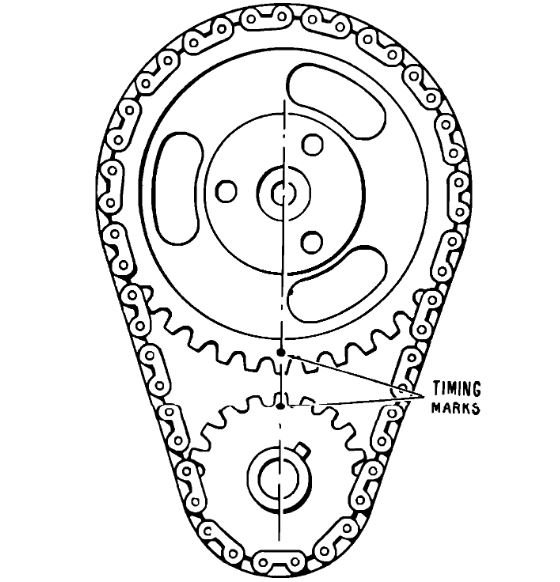

Hi, i have the truck listed above crew cab dually with the 7.4 liter (454) engine. I have brand new distributor cap and rotor,(it's hei ) new spark plugs and wires, new coil, fuel filter fuel line. I am getting spark and fuel i can pour gas down carburetor and it will still not start either. The story on this is the truck was driving and running amazing all summer. And then the next morning i went out and it started but had no power at all and would shut off with too much gas pedal, so i parked it for a couple days tried again started but same thing. Tried again week later and wouldn't start. it has has been 6 months and will not start. maybe you guys could help me. Maybe motor is wore out and low compression, but maybe not because it had tons of power all summer and the day before. And then just all of a sudden.

If it does not start with priming it, I would start with a compression test. If you have spark and fuel, that is the next test. You can rent a tester at a parts store.
If you have the original timing gears, the cam gear is made of fiber and is common for failing.

I was also just going to ask is it hard to look at the timing gears while the motor is still in the truck?
Sep 3, 2020 at 3:14 AM
Yes, it is. That is why I requested a compression test. If you have bad compression on all cylinders, that indicates a timing chain.
