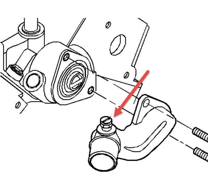

A week ago my car overheated and the heat was cold. I replaced the thermostat, antifreeze and bled the air out of the system. Everything seemed fine and then today, a week later, it overheated again. I was able to drive it home, but the temperature kept going from 1/4 to 3/4 on the gauge and alternated back and forth every thirty seconds or so. When it went down the heat was hot and when it went up the heat was cold. What could this be another bad thermostat or water pump?

outside temp has not much to do with an overheat.try bleeding air from system see pic there may be another screw for this so look on radiator and other cooling areas.

I bled the air out a few times. No more comes out.
May 23, 2021 at 4:32 AM
SATURNTECH9
  • 30,869 POSTS
Did you bleed it with the engine cold and the bleeder screw open while filling the cooling system with the engine off till the bleeder screw has a nice steady stream of coolant coming out of it?

To answer the last question, I bled it while filling it back up and then again when hot.

I filled up the antifreeze, bled it and started it up and I kept hearing a loud clicking sound every 30-60 seconds. I listened to various areas to figure out where it was and it was coming from the thermostat housing. Drove about 1/4 mile and overheated. The heat was cold. Could have another thermostat gone bad? I replaced it 2x in the past 3 weeks.
STEVE W.
  • 15,411 POSTS
A failed thermostat won't click. They will fail open or closed. I would still do a gas test on it. I am betting that the click is being caused by combustion gasses building up and forcing past the thermostat spring and it's then snapping shut. Because of the design of that engine with the thermostat at the bottom, you won't see bubbles in the coolant, only a combustion gas test would show it.

It's definitely the head gasket. It keeps getting air in the engine and overheating. If I bleed it out it will run for a couple of days and then do it again.
Will drilling a hole in the thermostat or removing it buy me any time by letting the air go to the radiator instead of getting trapped in the engine?
STEVE W.
  • 15,411 POSTS
That really wouldn't help. The reason that engine has bleeders is because it traps air in it. The only way for the air to get out is through them. The only good repair would be doing the head gaskets or swapping out the engine. Swapping is tricky though because GM used a few different control systems on that engine over the years. If you don't get one with the same system it won't run.
