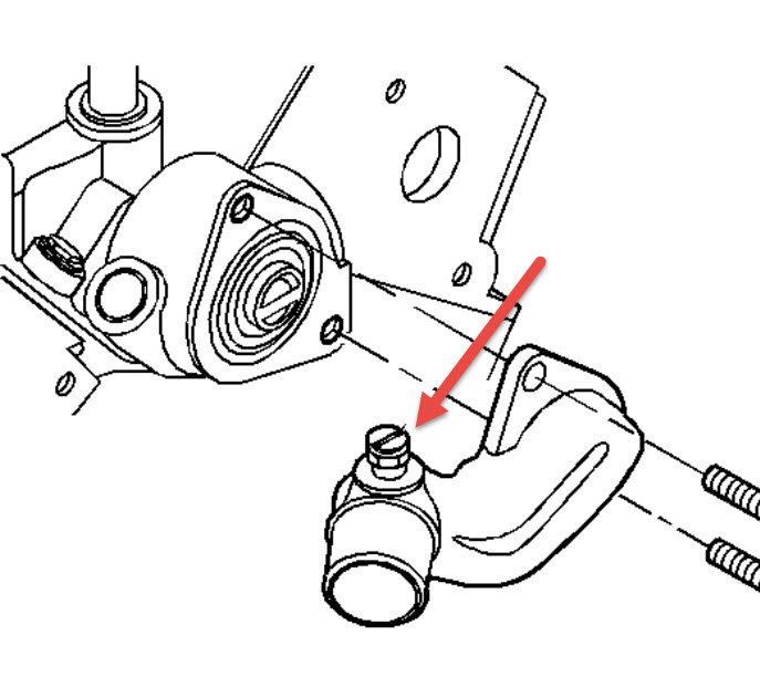

outside temp has not much to do with an overheat.try bleeding air from system see pic there may be another screw for this so look on radiator and other cooling areas.

I bled the air out a few times. No more comes out.

Did you bleed it with the engine cold and the bleeder screw open while filling the cooling system with the engine off till the bleeder screw has a nice steady stream of coolant coming out of it?

To answer the last question, I bled it while filling it back up and then again when hot.
