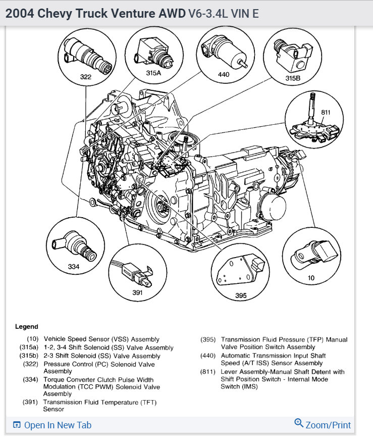

The transmission will not shift out of first gear It only stays in the gear that it is in when you put it in Drive and my speedometer is not working?

It sounds like the VSS has gone bad here is a diagrams below to show you the location so you can change it out. Check out the diagrams (Below). Please let us know if you need anything else to get the problem fixed.

Thanks for this post I had this problem and the VSS fixed it. I love this site.

Is the check engine light on? If so will need to have codes pulled.
Could be the In-Put and/or Turbine Speed Sensors or possible the TCM (Transmission Control Module)
