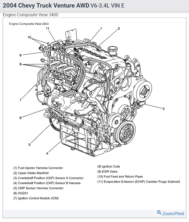

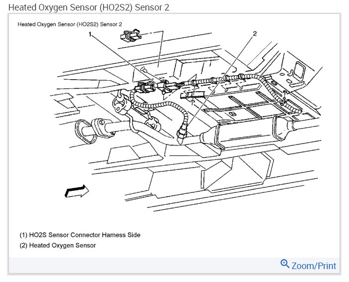

Where is the bank 1 sensor 2 located on my van?

Here is a guide to help you replace the oxygen sensor once you find it from the diagrams below:
https://www.2carpros.com/articles/how-to-replace-an-oxygen-sensor

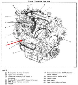

Oxygen sensor where is it? I cannot find it oxygen sensor.

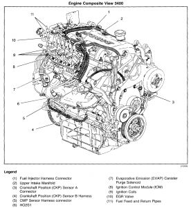

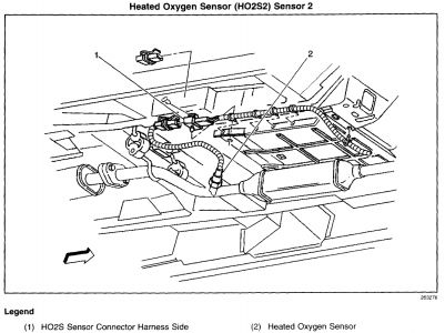

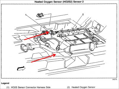

Here is the information you requested.
I gave you two pictures. One with red arrows and one without. Looks like you have two sensors.

Error code:
P0135 Bank 1 Sensor 1 Heater Circuit
This is an oxygen sensor that resides upstream from the catalytic converter.
I have been told that there are two O2 sensors upstream on this minivan.
The one of them that I can find resides just to the passenger side of the point where the two exhaust pipes (manifold?) Come together under and just behind the engine.
If there really is another upstream sensor, where is it and which one would I replace?

You have one before catalytic converter [bank one] another one behind catalytic converter [ bank two]. The bank one is more expensive than bank two.
