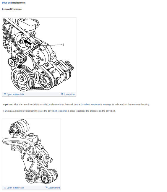

Diagram on how to put the Serpentine belt?

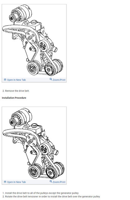

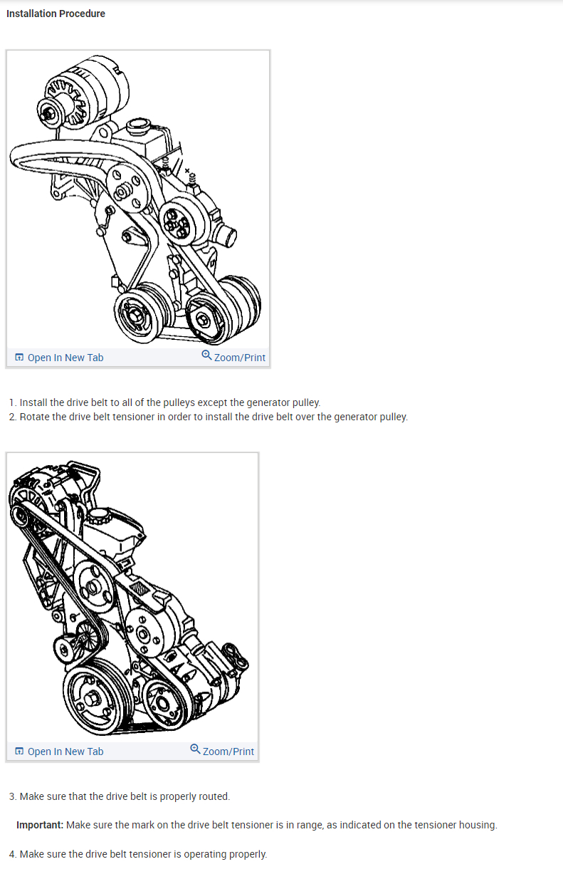

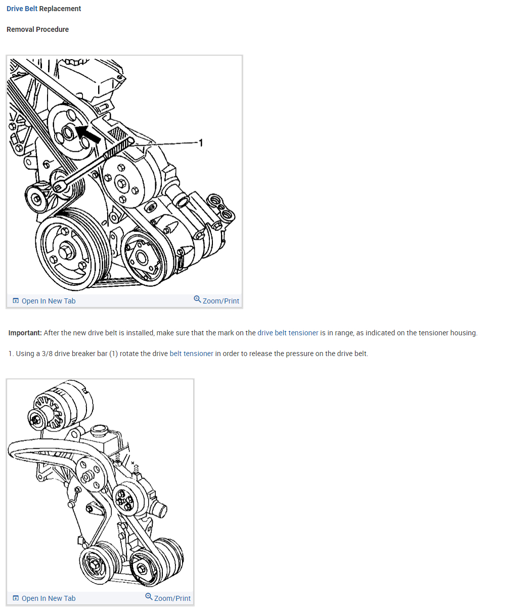

Below is a link to generic how to guide which is a good way to prepare and the diagrams attached have all the diagrams and instruction you need.

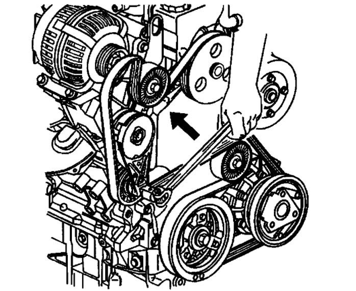

Need to see a belt diagram.

Good afternoon,
I attached the diagram for you below. It shows the location of the tensioner for you to release to remove the belt.
