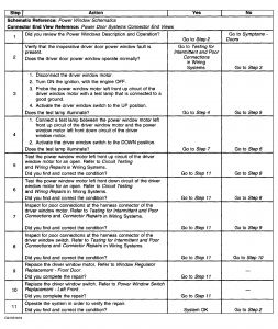

Window wont go up, replaced motor and switch still wont work, drivers side is fine. Will go down with new motor.
Wednesday, March 24th, 2010 AT 9:18 AM

Right click mouse button over diagram and save to your computer to read better
