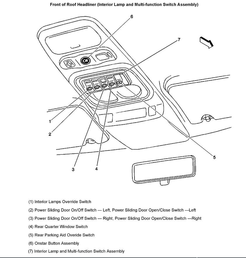

My van doesn't have interior lights.. all fuses check good
Aug 10, 2010 at 5:44 PM
BLUELIGHTNIN6
  • 16,542 POSTS
make sure the dome light switch is not turned off , if it is on test for power at the switch.It is located in the overhead console
See the diagram below
