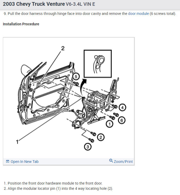

Drivers side power window wont go down but passenger side works just fine.I have checked fuse but im thinking both windows run off same fuse. Could it b the window motor or do the both run off the same thx
Wednesday, February 20th, 2008 AT 12:24 PM
SQM
  • 6,383 POSTS

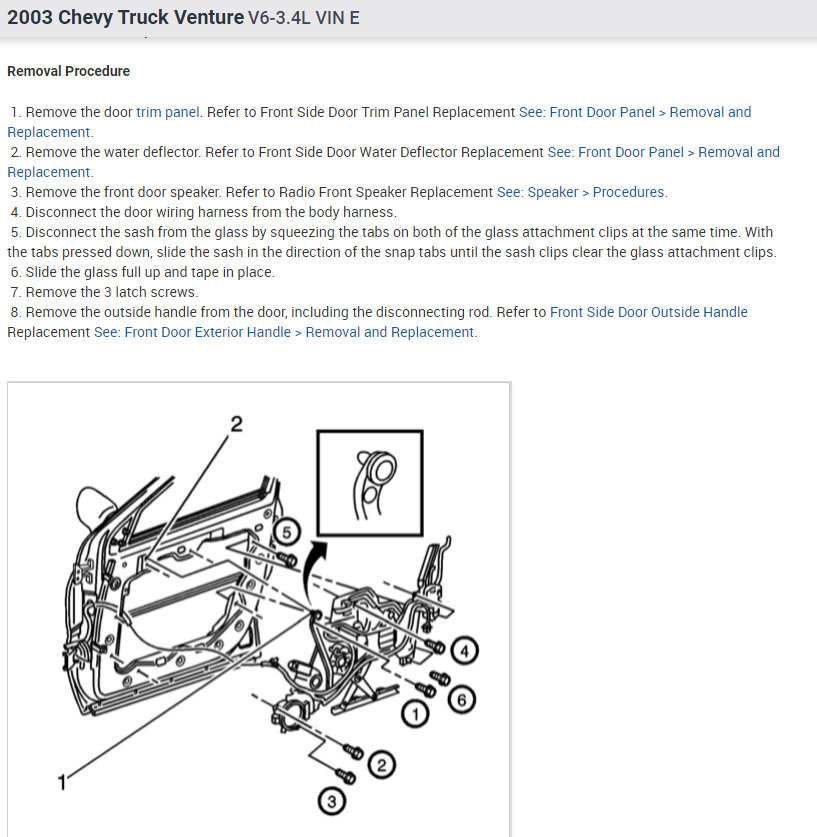

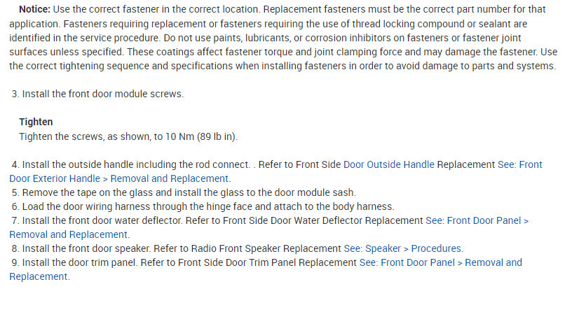

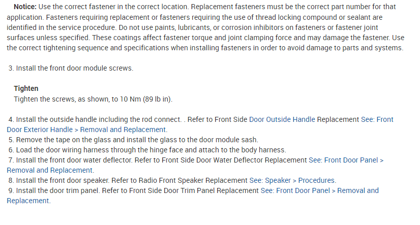

It sounds like you might have a faulty window motor on the driver side.
Replacing the window motor will require you to remove the inner door panel.
The door panel can be removed using basic hand tools. It is mounted by few screws and plastic fastens.
You might find this article helpful:
https://www.2carpros.com/articles/how-to-check-and-replace-a-electric-power-window-motor
https://youtu.be/oNxstjcA25k
I have attached the diagrams for your reference.
