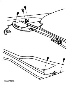

I have a 2001 Chevy Venture with some Problems I hope I may obtain some help on.
Recently my Central Locking has stopped working any attempt to lock the vehicle when in the car using the door lock buttons gives a clicking sound coming from the passenger side console.
I also have just lost Wiper control. Only the High Speed now works.
Has anyone had any of these problems and can direct me or help me diagnose these faults and I am unemployed and cannot afford to place this vehicle in a Shop.
Thank You..

TEST C: FRONT WIPERS INOPERATIVE IN ONE OR MORE MODES
If description and operation has been reviewed, go to next step. If description and operation has not been reviewed, go to DESCRIPTION & OPERATION .
Turn ignition switch to RUN position. Turn multifunction switch through all switch positions. If front wipers do not operate normally in all modes, go to next step. If front wipers operate normally in all modes, diagnose intermittent condition. See DIAGNOSING INTERMITTENTS in BODY CONTROL MODULES - MONTANA, SILHOUETTE & VENTURE article.
Turn ignition switch to LOCK position. Disconnect multifunction switch 48-pin harness connector C201. Harness connector C201 is located to left side of steering column, near base. Disconnect front wiper motor 6-pin harness connector. Check for open, high resistance or short to ground in Purple wire between front wiper motor and multifunction switch. See WIRING DIAGRAMS . If problem does not exist, go to next step. If problem exists, repair as necessary. After repair, go to step 13 .
Check for open, high resistance or short to ground in Gray wire between front wiper motor and multifunction switch. See WIRING DIAGRAMS . If problem does not exist, go to next step. If problem exists, repair as necessary. After repair, go to step 13 .
Check for open, high resistance or short to ground in Dark Green wire between front wiper motor and multifunction switch. See Fig. 2 and Fig. 3 and WIRING DIAGRAMS . If problem does not exist, go to next step. If problem exists, repair as necessary. After repair, go to step 13 .
Measure resistance between multifunction switch pigtail harness connector C201 terminals E3 (Dark Green wire) and E9 (Yellow wire) - (component side). See Fig. 3 . Turn wiper portion of multifunction switch to MIST, LO and HI positions. If resistance is less than 2 ohms, go to next step. If resistance is 2 ohms or more, go to step 10 .
Measure resistance between multifunction switch pigtail harness connector C201 terminals E3 (Dark Green wire) and E9 (Yellow wire) - (component side). Turn multifunction switch through all DELAY positions. Resistance should be 39-680 k/ohms. If resistance is as specified, go to next step. If resistance is not as specified, go to step 10 .
Measure resistance between multifunction switch pigtail harness connector C201 terminals E3 (Dark Green wire) and E9 (Yellow wire) - (component side). Turn wiper portion of multifunction switch to MIST, LO and HI positions. Resistance should be 24 k/ohms. If resistance is as specified, go to next step. If resistance is not as specified, go to step 10 .
Connect multifunction switch harness connector C201. Connect front wiper/washer motor harness connector. Turn ignition switch to RUN position. Turn wiper portion of multifunction switch to HI position. If front wipers operate normally, go to step 11 . If front wipers do not operate normally, go to step 12 .
Replace multifunction switch. See REMOVAL & INSTALLATION . After repair, go to step 13 .
Replace front wiper drive system module. See REMOVAL & INSTALLATION . After repair, go to step 13 .
Replace front wiper motor. See REMOVAL & INSTALLATION . After repair, go to next step.
Operate system to verify repair. If problem does not exist, system is okay. If problem still exists, go to step 3 .

Hi Dave
Many thanks for your Detailed Response
With regards to the Wiper Problem.
I had a Friend Listen to the Motor when Slow is Selected and there is a Clicking at the motor so would that indicate a Burned Out motor do you think?..

Hey .. thanks for the donation .. much appreciated. I would replace the wiper module, as the motor is working in the HI position (9) Connect multifunction switch harness connector C201. Connect front wiper/washer motor harness connector. Turn ignition switch to RUN position. Turn wiper portion of multifunction switch to HI position. If front wipers operate normally, go to step 11 . If front wipers do not operate normally, go to step 12 . (11) Replace front wiper drive system module. See REMOVAL & INSTALLATION . After repair, check system functions correctly FRONT WIPER DRIVE SYSTEM MODULE Removal Remove wiper arms. See WIPER ARMS . Remove air inlet grille panel. See AIR INLET GRILLE PANEL . Remove cruise control module and bracket. For removal and installation procedure, see CRUISE CONTROL SYSTEMS - MONTANA, SILHOUETTE & VENTURE article. Remove wiper motor. See WIPER MOTOR . Remove wiper drive system module screws. See Fig. 7 . Remove wiper drive system module from vehicle. Fig. 7: Removing & Installing Wiper Drive System Module
https://images.2carpros.com/forum/automotive_pictures/266999_7_7.jpg
Hope this helps
