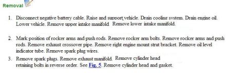

can someone tell me the procedure for removing the head gasket(s) on a 2001 chevy venture(3.4 liter) or can someone show me a diagram.

BLUELIGHTNIN6
MECHANIC
16,542 POSTS
FIG. 5
