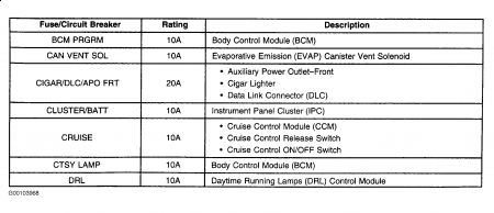

My front Auxillary power supplies don't work. And I can't find the fuse that controls them.

https://images.2carpros.com/forum/automotive_pictures/266999_vent_4.jpg
