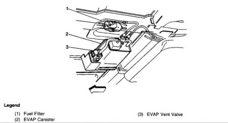

Where is the fuel filter and how do I change it out?
Jun 12, 2010 at 4:05 PM
  • 75,992 POSTS
Fuel filter (location view)
https://images.2carpros.com/forum/automotive_pictures/12900_ff_17.jpg
https://images.2carpros.com/forum/automotive_pictures/12900_ff1_4.gif
REMOVAL PROCEDURE IMPORTANT: There is no service interval for in-pipe fuel filter replacement. Only replace the in-pipe fuel filter if it is restricted. 1.Relieve the fuel system pressure. Refer to Fuel Pressure Relief Procedure. 2.Raise the vehicle. Refer to Lifting and Jacking the Vehicle in Service Precautions. 3.Remove the quick-connect fitting at the inlet of the in-pipe fuel filter. 4.Remove the quick-connect fitting at the outlet of the in-pipe fuel filter. 5.Drain any remaining fuel into an approved gasoline container. 6.Remove the in-pipe fuel filter mounting bracket attaching nut. 7.Remove the in-pipe fuel filter and mounting bracket. 8.Remove the in-pipe fuel filter from the in-pipe fuel filter mounting bracket. INSTALLATION PROCEDURE 1.Remove the protective caps from the new in-pipe fuel filter. 2.Install the in-pipe fuel filter into the in-pipe fuel filter mounting bracket. 3.Install the in-pipe fuel filter and mounting bracket. NOTE: Refer to Fastener Notice in Service Precautions. 4.Reinstall the in-pipe fuel filter mounting bracket attaching nut. Tighten Tighten the nut to 10 N.m (89 lb in) . 5.Connect the quick-connect fitting at the inlet of the in-pipe fuel filter. 6.Connect the quick-connect fitting at the outlet of the in-pipe fuel filter. 7.Lower the vehicle. 8.Tighten the fuel fill cap. 9.Reconnect the negative battery cable. 10.Inspect for fuel leaks. **10.1. Turn the ignition switch ON for 2 seconds . **10.2. Turn the ignition switch OFF for 10 seconds . **10.3. Turn the ignition switch ON. **10.4. Check for fuel leaks. https://www.2carpros.com/kpages/auto_repair_manuals_alldata.htm

While replacing the fuel filter on my 2000 Chevy Venture, I lost the screw that mounts it to the chassis. Anyone know the size or part number of the screw?
Sep 30, 2019 at 9:12 AM
  • 55,325 POSTS
Was it machine thread or sheet metal? You should be able to go to Home Depot and find one that will work. 1/4 inch or 8 mm.
