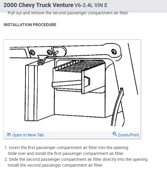

I would like to change the cabin passenger side air filter in my van. Could you tell me the procedure.

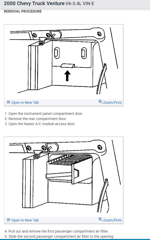

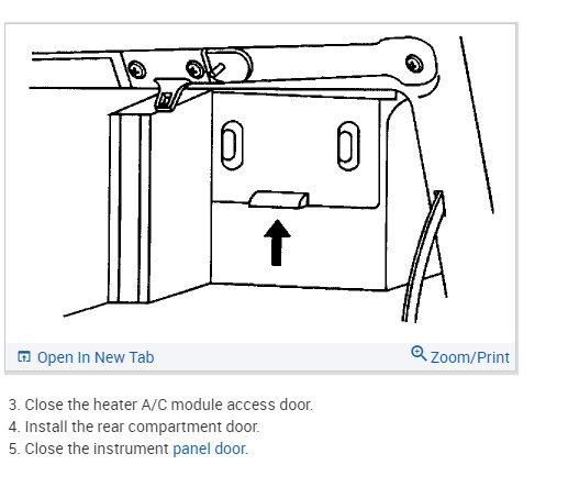

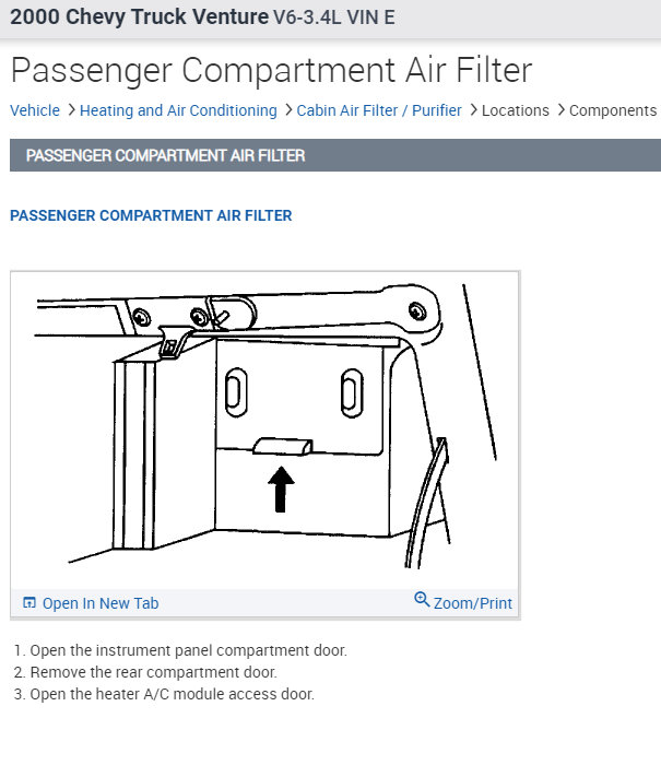

The cabin air filter is located behind the glove compartment on the passenger side dash.
You will have to open the glove box and remove the cover for the cabin air filter.
Here is a helpful guide:
https://www.2carpros.com/articles/how-to-change-an-air-cabin-filter
I have attached the replacement procedure below.
