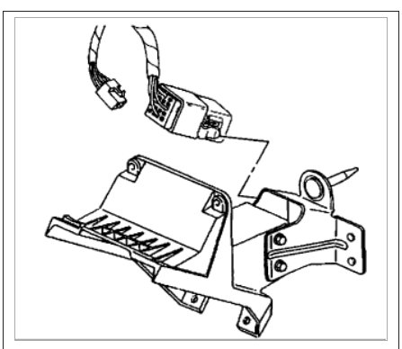

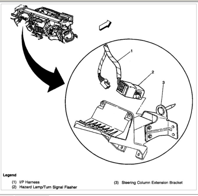

Electrical problem 6 cyl Front Wheel Drive Automatic 357000 miles
My directionals, flashers only work intermittently, where is the flasher located to enable replacement?
Mar 23, 2010 at 4:45 AM
  • 55,649 POSTS

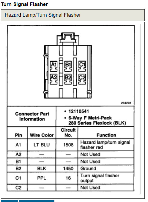

The turn signal flasher is located at the steering column. You need to remove the trim panel to access it. Here are some diagrams (Below) of its location.
