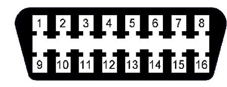

I'd probably start by checking the pins at the datalink connector. Pin 16 is battery voltage, pin 4 is chassic ground, I believe. I don't know if a scanner will say abort if there is voltage available? It doesn't hurt to check.

I checked the voltage to those pins...nothing. So I pulled every fuse one at a time and lo and behold, the OBD port is on the Cigarette Lighter circuit. Replaced that 15A fuse, and now it works.

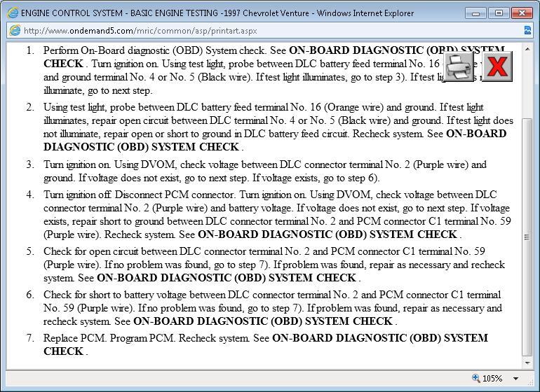

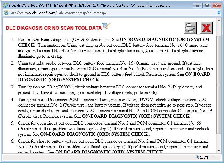

I posted the trouble tree for no com with scan tool follow the trouble tree and let me know what you find.

All those checks have been completed already and the pcm replaced with a working one from an other 97 venture. The pcm has 12 volts at pins c1-20,c1-19 and grounds at c2-60 c2-21 and c1-60,c1-19. Both the original and the replacement act exactly the same.

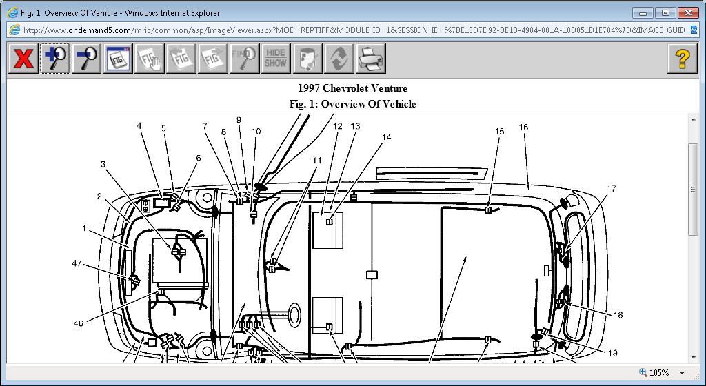

The bcm is number 7 in the digram see if its there?

The body control module was there. It checked good, so started trouble shooting all over , used a one amp load to check supply voltages .I found the voltage at c1-20 dropped to zero when loaded to one amp. Started checking the voltage at the fuse, Opened up the wiring harness going to the computer and found batter acid fumes had gotten in to the heavy duct and was eating the insulation and corroding and eating away the copper wire. This spot was right over the top of the battery. Spliced the wire and was back in business with the car running. and the innova 3100f working showing trouble codes that may also be caused by the wiring.
