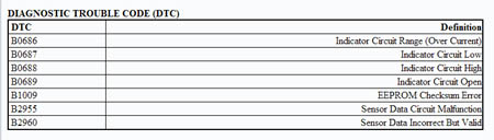

my bcm has a code 1234 what is this and how can i reset it?

These are the Valid BCM codes, cannot find yours!

well I'm trying to reprogram the key fob/remote and i remove the bcm fuse and turn the key to ACC it chimes lvl 4 but when i turn the key to off then ACC it chimes---chimes-chimes---chimes-chimes-chimes---chimes-chimes-chimes-chimes---then repeats X3 times whats that then? or am i going at reprograming the fod/remote all wrong?

It may be stuck in a program mode...try putting the fuse in and starting over...

i found the problem my daughter turned on the back two lights after i turned them off i didn't get that error but i think my receiver is broke, i took my key fob to auto-zone and checked it, its good , so i guess the receiver isn't receiving :(
