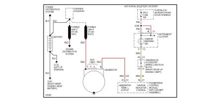

I have a 1999 Chevy Venture and the charging light is now coming on. Replaced the battery (battery was tested and was bad), but the same problem is there. If I idle up the motor slightly the light will go away, but at an idle the light will light back up. I have had the alternator replaced approx. 3 years ago (again tested and was said to be bad). warranty and extended warranty now out of the question so I am on my own, any help would be appreciated. I can do most of the work myself just need some suggestions.
Thank you,
Jul 11, 2010 at 12:14 AM
  • 75,992 POSTS
Have the computer alternator field generation circuit tested-see below
