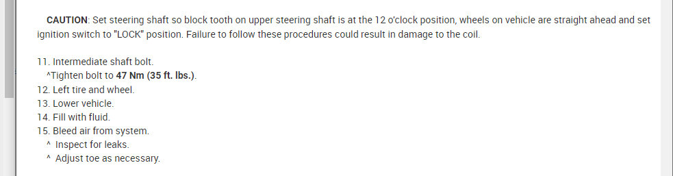

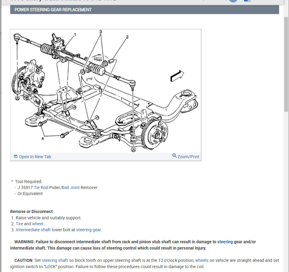

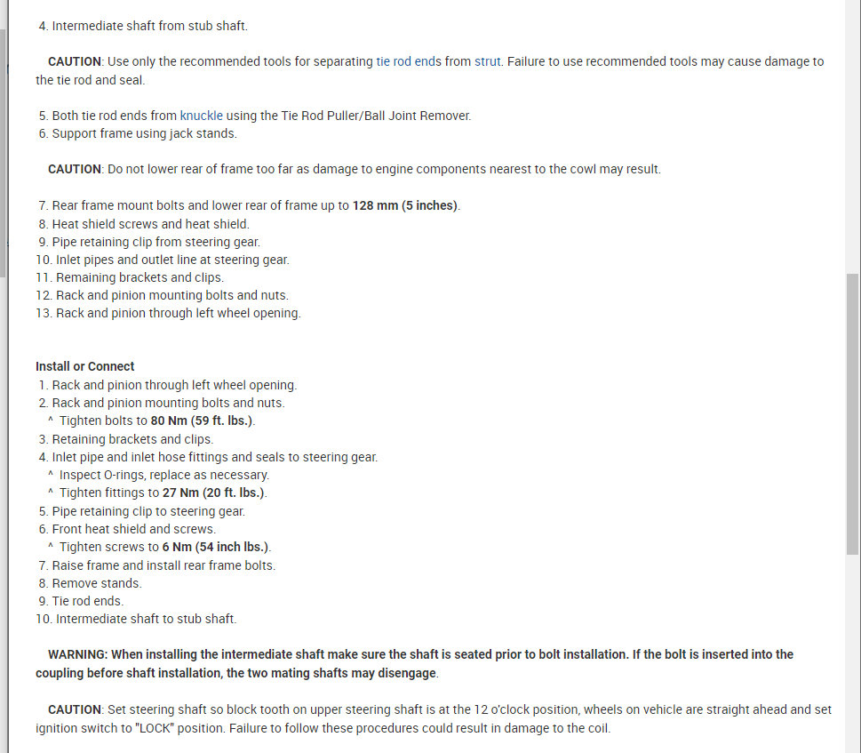

Below you will find the process on how to replace the gear which in your case is a rack and pinion steering gear.
Please run through this material and let us know if you have other questions. Thanks
