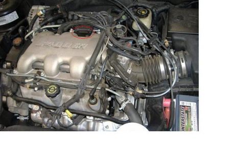

Where to find the Map sensor in venture model

Map sensor is located
Two 7mm bolts fasten the MAP to a bracket. I have highlighted it in red on the picture.
