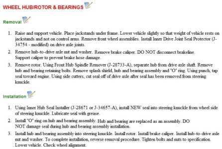

how can i change front wheel bearings

https://images.2carpros.com/forum/automotive_pictures/261618_Noname_1980.jpg
