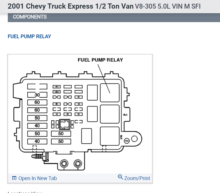

fuel pump is good i think the relay is shot where would that be and is there a test?

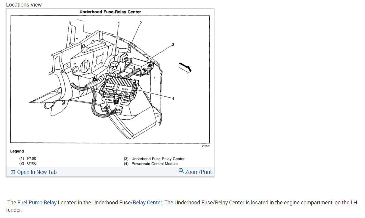

the fuel pump relay is in the underhood fuse block (on left side of firewall). to learn how to test a relay, check out this link the location of the relay is below.

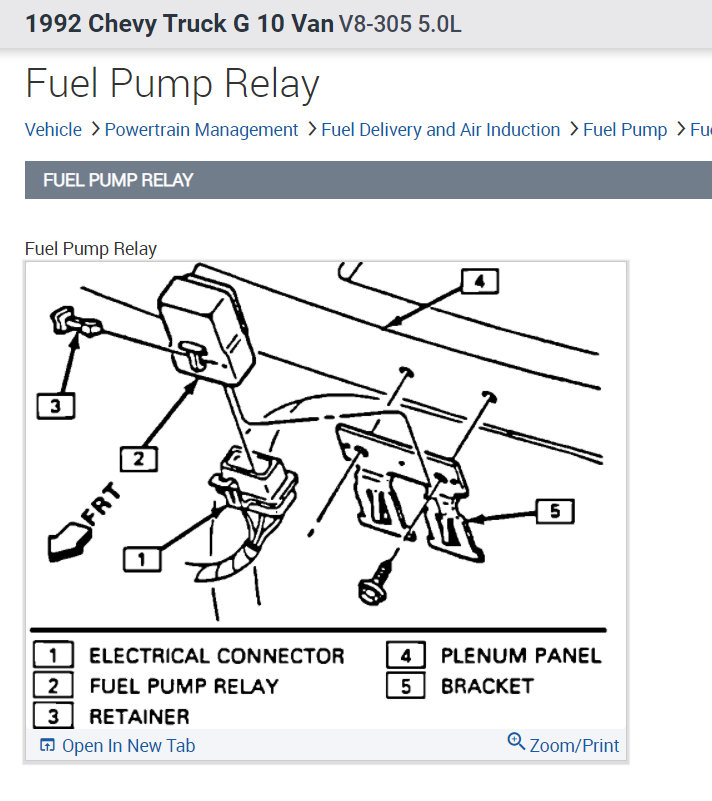

if the engine started then it 's probably the pump not the relay check fuel pressure shodlbe 9-13 psi auto parts rent gauge you may need an adapter as well. see pic for relay underhood item 3. if the gray wire has power then check at tank that is wire leading to pump.

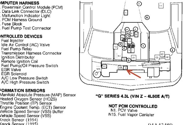

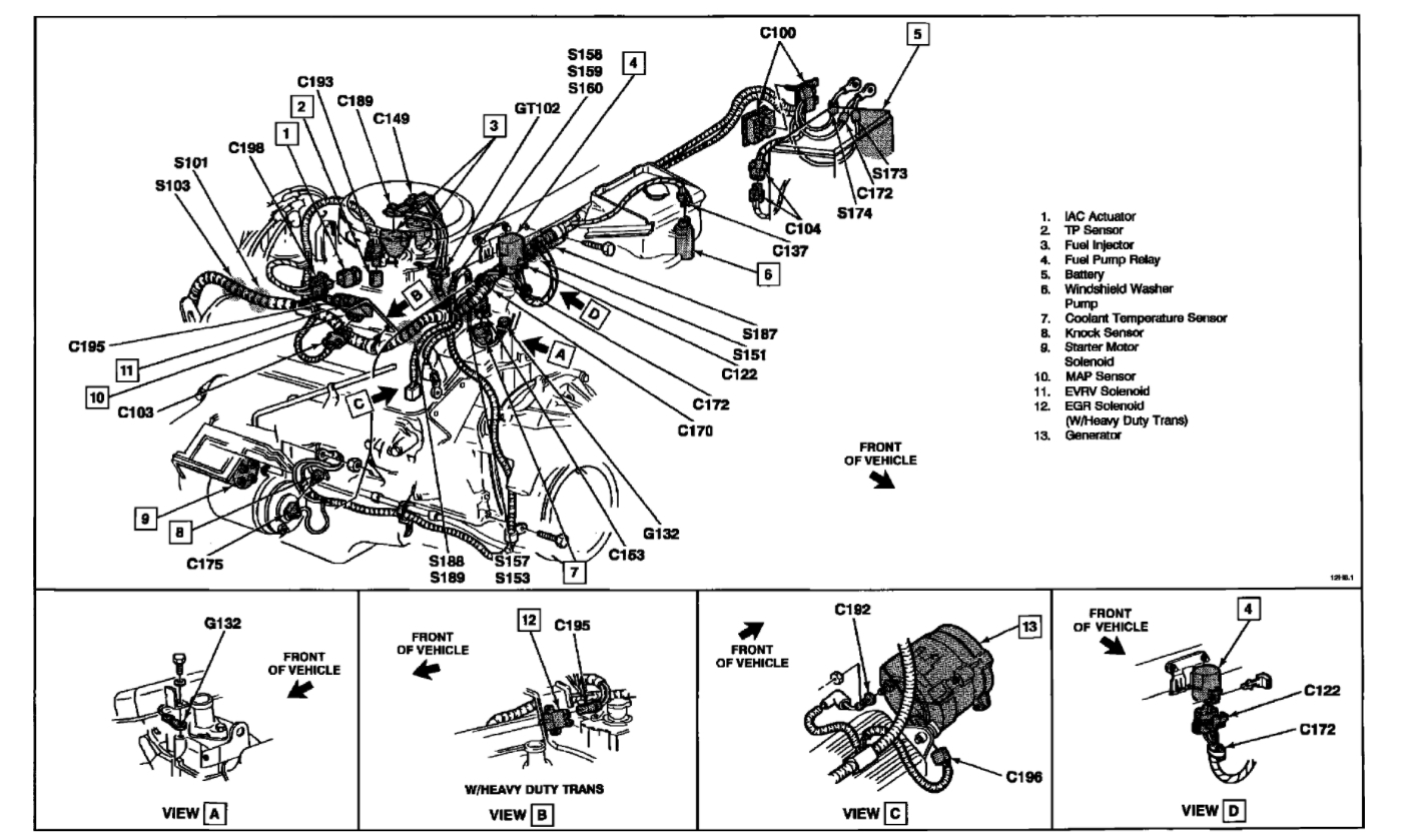

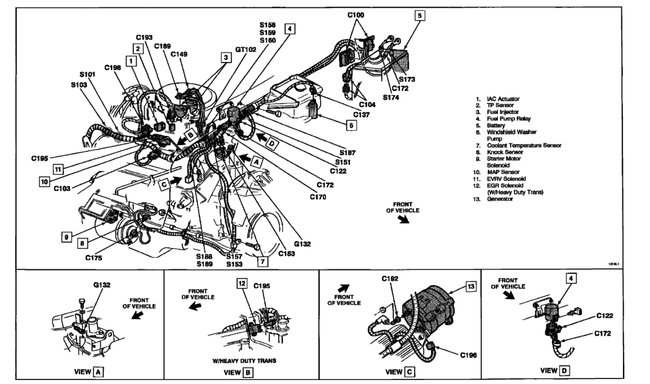

It should be under the hood here is a guide to help test it with the fuel pump relay in the diagrams below.
