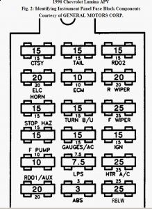

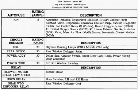

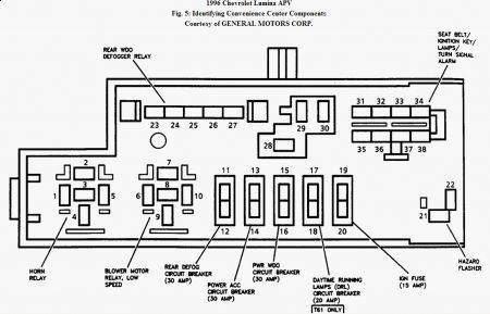

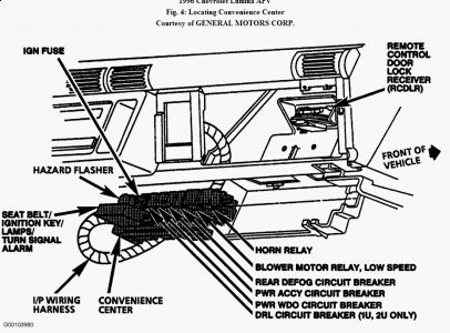

My ac and Power Windows Went out at the same time....doors locks works and radio does too........ relays our good also are the fuses........ What could have cause this ? ? ? ?
Mar 27, 2009 at 10:22 PM
MERLIN2021
  • 17,250 POSTS
Check both the convience center, and fuse panel as marked. LPS fuse in fuse panel and Power WDO breaker in convienience center.
