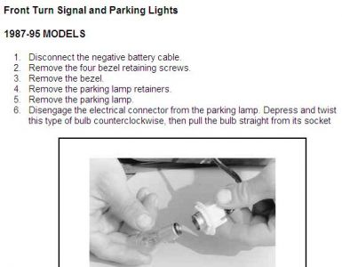

How do I change the bulb for the signal lights in the driver side light housing?

Welcome to the forum.
https://images.2carpros.com/forum/automotive_pictures/170934_95_chevy_van_1.jpg
If the bulb has retainer pins, you push in just a little, turn ccw a bit, then pull the bulb out.
