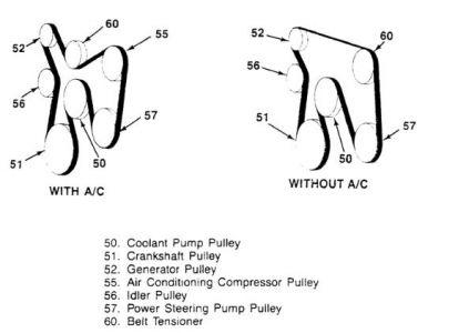

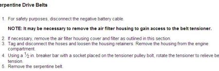

where is the tentioner at so i can get the pump off
Apr 9, 2009 at 1:48 AM
JDL
  • 16,098 POSTS
https://images.2carpros.com/forum/automotive_pictures/170934_G11_1.jpg
I didn't know the van model or litre size of engine?
https://images.2carpros.com/forum/automotive_pictures/170934_G_1_1.jpg
G van.
