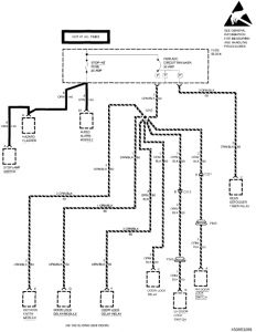

HI everyone and thank you in advance for your assitance. I am at the begining of diagnosising a battery drain. Customer reports battery will go dead after sitting over night. I have tested the battery suing a Snap On tester, it is ok, 650 CCA, alternator has also checked out ok 15.2v. I placed my ameter in line with the neg battery terminal and let the van sit for 20 minutes. While monitoring the meter I am getting a.225 draw. I started removing fuses until the drain fell below.02. The fuse that caused the drop is the "STOP HZ" fuse. Can anyone point me to a problem location and or a wiring diagram for this curcuit?

The diagram did not show up, would you please email it to me?

It should be visible to you. Here it is uploaded

Its to small I cant read it

Then save it and enlarge it.
There is nothing else I can do. I hosted at an image site so you could see it larger but you seem to be the only one that can't read it. I can see it clearly. When I upload it, the site reduces the size so I can't change that.

You did a great job! Thanks, I was able to take the image and got it to work, thanks again. It appears the "audioable" warning is also on that curcuit. IIRC I heard no dinging or buzzing while working on it. Ill start there tonight. This is my Aunts van and I am just helping her out. I am not making anything on this job. I appreciate the help, thank you.

Yes, that was audio alarm module.
