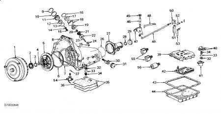

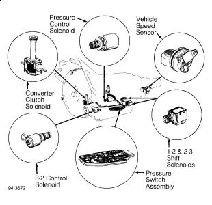

since the time between transmissions has the battery been disconnected? If not disconnect, wait 5 minutes then reconnect. do not remove the negative side. has the van been scanned? there could be a couple of things that would make both transmissions do this, check the Tp sensor, Vss, shift solonoid and the pressure control solonoid. With disconnecting the battery most cars or vehicles around the beginning 1990s will have to be driven about 50 miles before the computer resets itself. this does not have to be all at once. When the computer is reset then have it scanned to find out what solonoid could be doing it. Resetting the computer will also reset the abs. If the problem reoccurs then you have to have it looked at.

Hello, can you tell me what Tp sensor, Vss, shift solonoid and a pressure control solonoid are? and were can I find them?

the tp is throttle control , the vss is vehicle speed conteol, pressure contol is what it says. the sensors are on the transmission. Yes a broken wire or bad plug will do what you are posting. Since you have had one transmission break down check all the electrical connections,
