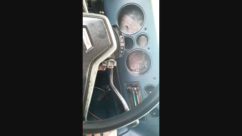

Did you ever figure this squeaking out?? I am having this exact same problem in my 1989 G20.

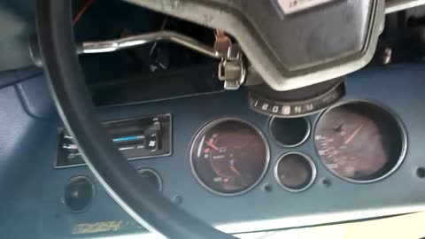

Thanks for the reply! This is the sound. Chirping a lot, in drive or park or reverse. This happens when moving, or idling. I don't notice it happening in neutral. As you see in the video, adjusting or touching the shifter slightly will stop or exaggerate the chirping. Thank you for any help!!!!!

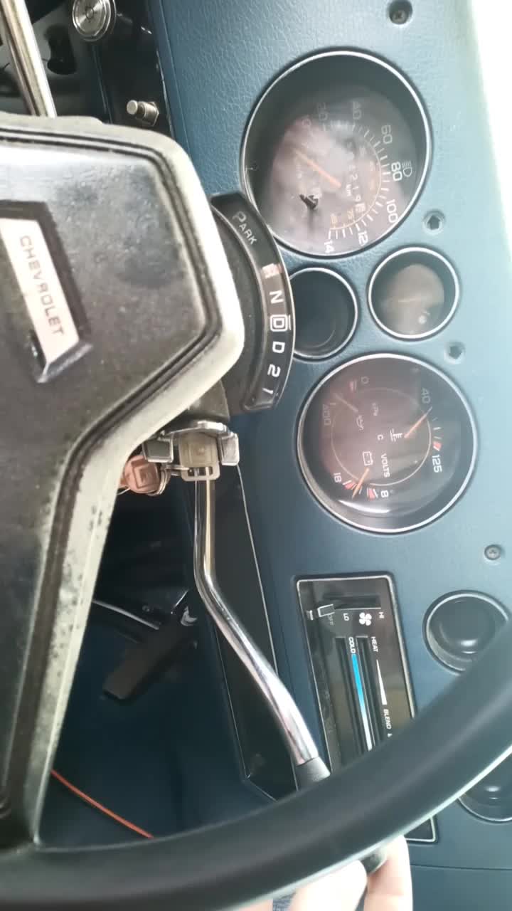

Okay, no problem. does this video sound any louder or better?
Jun 9, 2021 at 8:47 AM
Much better.
I would start by removing the drive belt and see if the noise is still there. It could be one of the pulleys, water pump, or alternator bearings making the noise.
Jun 9, 2021 at 10:28 AM
MATT1987

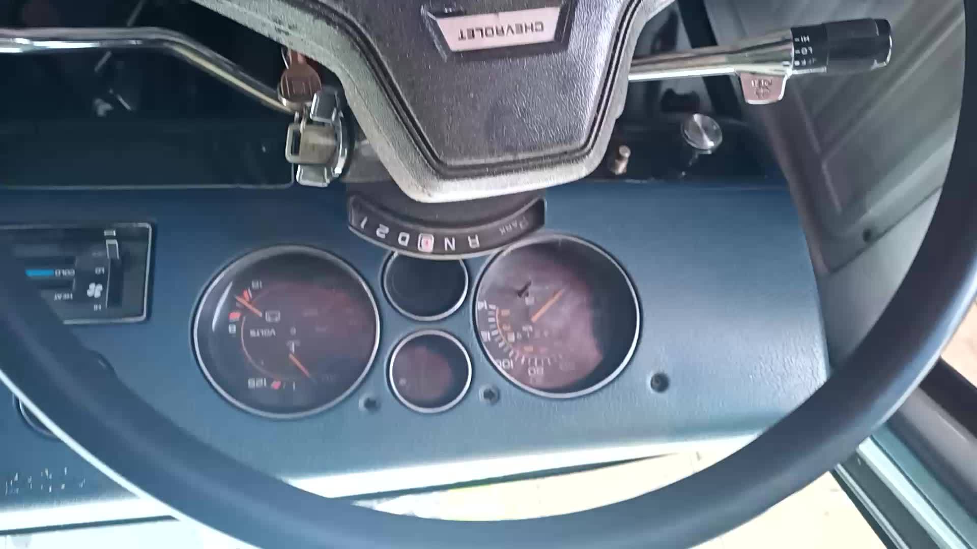

The part that puzzled me, is that as you can see in the video when I touch or slightly move the gear selector, it can stop the noise all together, but eventually the noise does come back. Do you still think that would have to do with the drive belt? Thanks for your help!
Jun 9, 2021 at 11:24 AM
Yes, I do. You need to start somewhere and that is where I would start.
