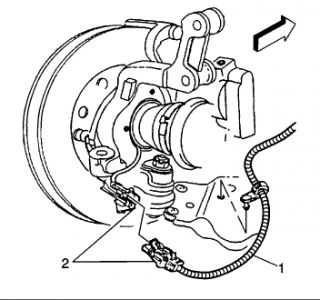

Wheel Bearing/Hub Replacement - Front Tools Required: J 28733-B Front Hub Spindle Remover Removal Procedure: Raise and support the vehicle. Refer to Vehicle Lifting. Remove the tire and wheel.
https://images.2carpros.com/forum/automotive_pictures/12900_w1_16.jpg
Disconnect the wheel speed sensor electrical connector (2).
https://images.2carpros.com/forum/automotive_pictures/12900_w2_9.gif
Remove the wheel speed sensor electrical connector from the bracket. Remove the brake caliper bracket with the brake caliper. Remove the brake rotor. Remove the wheel drive shaft nut.

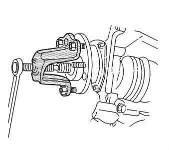

Use three wheel nuts in order to attach the J 28733-B to the wheel bearing/hub. Use the J 28733-B in order to push the wheel drive shaft out of the wheel bearing/hub.
https://images.2carpros.com/forum/automotive_pictures/12900_w4_2.gif
Remove and DISCARD the wheel bearing/hub bolts. Important: Ensure that the wheel drive shaft outer seal boot is not damaged. Remove the wheel bearing/hub. Installation Procedure
