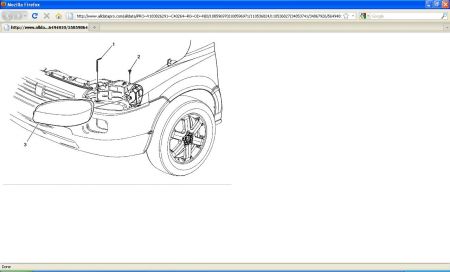

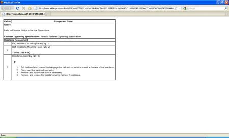

how to change headlight bulb?

There you go i also emailed it to you.
