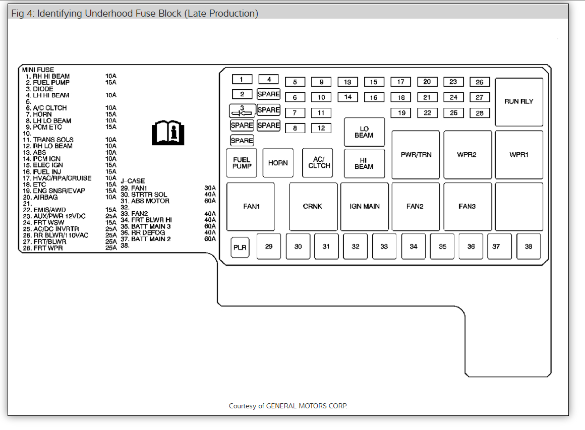

Deso this car have a fuel shutoff switch if so where is it?

This car does not have one it has a fuel pump relay which is located under the hood here is a diagrams of its location.
Image (Click to make bigger)
