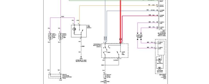

I have a 2008 chevy uplander - But the horn goes off and the wipers turn on the lights blink but it wont start what do i do. first time this happened but wife was stranded and unhappy help me make her happy
Feb 12, 2012 at 6:47 AM
  • 110,248 POSTS
Is the security light coming on? It sounds related to it. Check the battery it could be low on charge. Here is a guide
Feb 12, 2012 at 9:55 AM

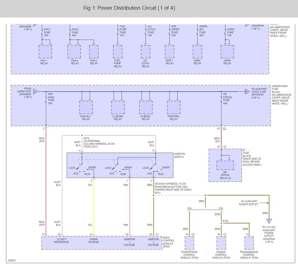

ARC77079
Car starts and then wont start. First thing I check was the battery and terminals battery is good and terminals are tight. In dash system shows battery to be between 12 and 13.9 volts so I know there is enough power to start. When I turn the key all power comes on without surge. Second position I can hear the "click" that engages the starter but when I get to the third key position the engine will not turn over. It makes no sound, no clicking to tell me the starter is bad, no sound at all. Is this the solenoid? How do I find out what the problem is. I am not a mechanic but am very inclined so I don't have volt meters or anything like that. On an old car I would just stick a screw driver in the solenoid but on a newer car I don't know what to do. Any help is appreciated. Thanks
Jul 9, 2019 at 10:37 AM (Merged)
SATURNTECH9
  • 30,869 POSTS
Get a test light and see if you have power to the small purple wire at the starter with the key in the start position when it doesn't start?If battery and connections are good and you have power there when it doesn't start bad starter.

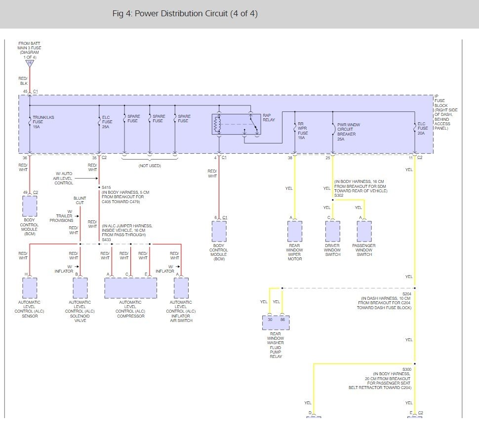

BULL1772
I have lights, locks, but no instrument panel power sliding doors and it will not even try to turn over, nothing. no clicking of starter, nothing. However, if the starter is jumped it starts up but shuts off immediately after removing power.

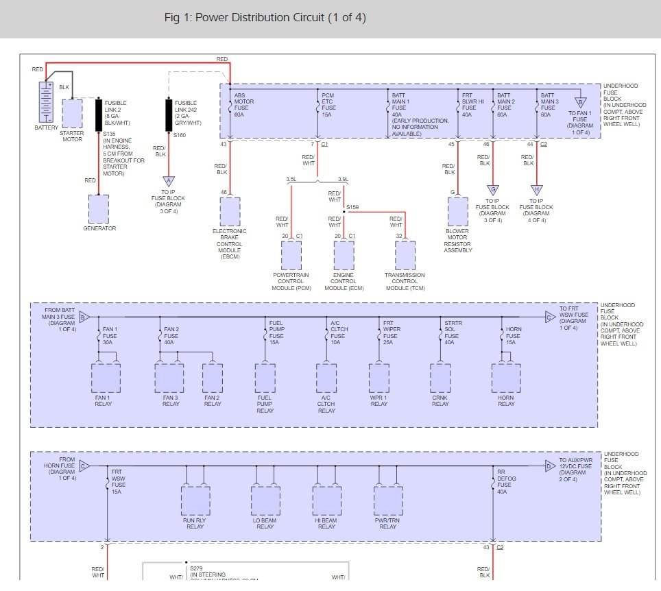

  • 55,743 POSTS
It sounds like either the ignition switch is bad or you lost a fusible link. Here is a guide to help you get started along with the wiring diagrams for your car. Use the test light to test for power at the switch and the fuse panel.
Please let us know what happens, we are interested to see what it is.
BULL1772
Thanks but I found the issue. It was the digital media/radio amp. I'm assuming it was interfering with the security system. Pulled the fuse (#4) for the amp and it started right up.
Thanks again, Scott
