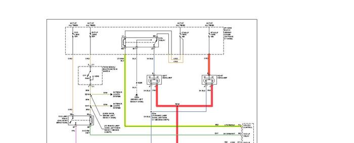

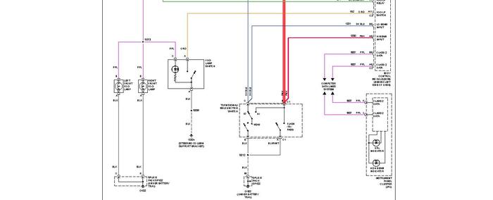

I have lights, locks, but no instrument panel power sliding doors and it will not even try to turn over, nothing. no clicking of starter, nothing. However, if the starter is jumped it starts up but shuts off immediately after removing power.

It sounds like either the ignition switch is bad or you lost a fusible link. Here is a guide to help you get started along with the wiring diagrams for your car. Use the test light to test for power at the switch and the fuse panel.
Please let us know what happens, we are interested to see what it is.

Thanks but I found the issue. It was the digital media/radio amp. I'm assuming it was interfering with the security system. Pulled the fuse (#4) for the amp and it started right up.
