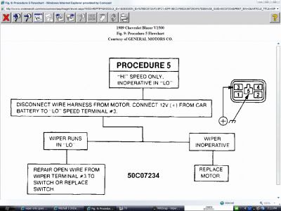

89 fullsize blaser k-5. wiper blades only goes one speed- fast. have replace motor and switch in steering column. could it be the wiper module and where is it.

Here's the test proceedure, K5 Blazer only not Van or Motorhome!
https://images.2carpros.com/forum/automotive_pictures/62217_WiperK5_1.jpg
https://images.2carpros.com/forum/automotive_pictures/62217_30961_mitchell_2_53.jpg
