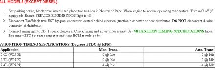

CARUNDELL
  • 602 POSTS
https://images.2carpros.com/forum/automotive_pictures/47722_Noname_1.jpg
Hey Jeff, Here ya go! Chris
Jan 23, 2007 at 7:16 PM
JAMMER
  • 20 POSTS
Chris, on the chart am I understanding it correctly where it says to reconnect Est by-pass connector, is the truck suppose to be running when I do this? I thought that i read in some book do not plug or unplug when motor is running, it may hurt comp.
Jeff
Jan 24, 2007 at 2:47 AM
CARUNDELL
  • 602 POSTS
[quote:9a162eddc2="jammer"]Chris, on the chart am I understanding it correctly where it says to reconnect Est by-pass connector, is the truck suppose to be running when I do this? I thought that i read in some book do not plug or unplug when motor is running, it may hurt comp.
Jeff[/quote:9a162eddc2]
Hey Jeff,
Let the truck warm up to operating temp, shut down, unplug est bypass, start, time, shut down, plug in est bypass and you should be good to go
Chris
Jan 24, 2007 at 2:53 AM

Hey Jeff,
Not sure if I understood your last post. Its timed @ 0 degrees w/ the EST plugged in? If so its not timed correctly. It should be @ 0 degrees w/ the EST unplugged and then plug it back in. (after you shut it down of course!) Home all weekend, let me know!
Chris
