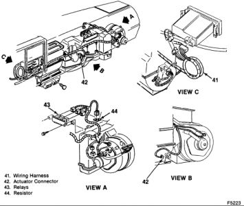

I have a 2005 chevy truck and today the first 3 speeds on the heater fan stopped working, only runs on 4 (high). I searching the web, it appears that the problem is with the Blower Motor Resistor. One, would you agree with this, and two, were is the resistor located on a 2005 colorado. thanks colorado101
Sep 26, 2020 at 7:17 AM (Merged)
CLY
  • 308 POSTS
I would have to agree that the prolem is probably in that resister. The resister is located under the dash near the blower motor. In the pcture that I have added it is #2...Hope this helps

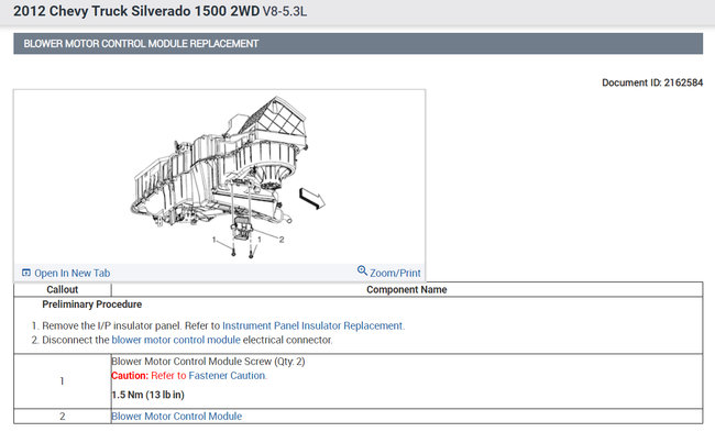

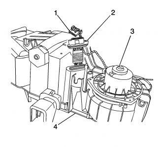

7.4
need locataion of heat&air blower motor resistor.it needs to be replaced. it has A/C
Sep 26, 2020 at 7:18 AM (Merged)

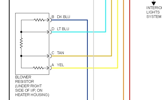

  • 75,992 POSTS
Blower Motor Resistor Wiring Diagram - Heater & A/C Underdash
https://images.2carpros.com/forum/automotive_pictures/12900_blowermotor_1.jpg
