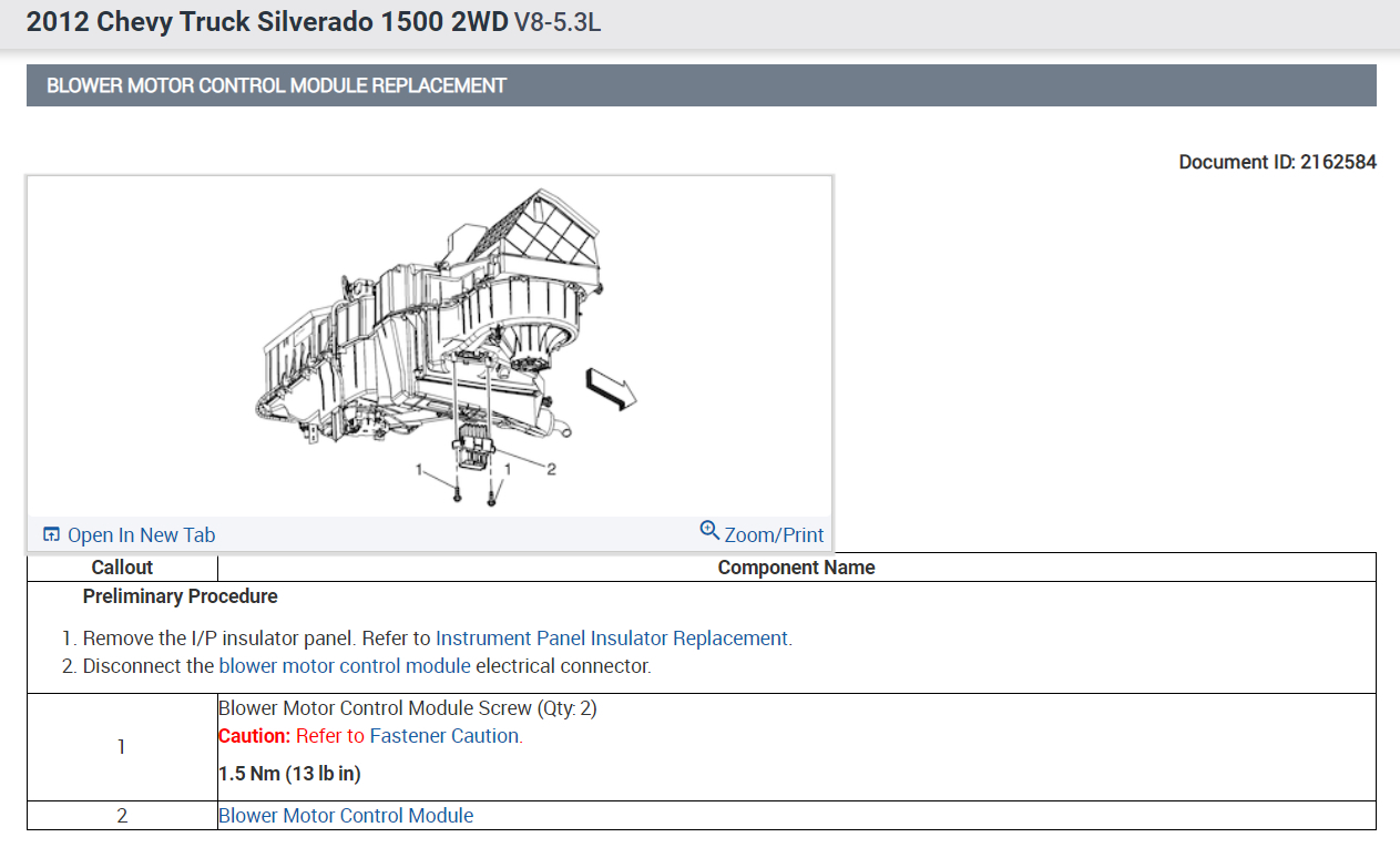

blower motor resistor located?
2012 CHEVROLET TRUCK
KADIAZ
My fan for air/heat works on high only. The local auto parts store said that this was the blower motor resistor part. Where is the blower motor resistor located? If it is under the dash can it be replaced w/o having to take the dash apart?

The blower motor resistor is usually located in or right close to the blower motor Usually you'll notice that the switch feels looser than normal when you use it. Here is the location of the blower motor speed control module (resistor) below.

I went to the local Chevrolet dealer & had the parts department print off their diagram of where the blower motor resistor was...I then followed their diagram & took the radio, control panel for fan & cd player out & it was not there! I gave in & took it to a mechanic. To get to the blower motor resistor on a 1995 Chevy Tahoe take out the glove compartment & behind it you will see lots of black plastic covering. The upper left of that platic has a metal bracket bolted there w/some wires. Disconnect the wires & remove the bracket & slide your hand up over that spot where the bracket was & there it is! No where near where Molle Chevrolet said! 2 bolts & a wire plug hold it on...take them out & put new on - it is a tight fit but can be done.

I have a 2005 chevy truck and today the first 3 speeds on the heater fan stopped working, only runs on 4 (high). I searching the web, it appears that the problem is with the Blower Motor Resistor. One, would you agree with this, and two, were is the resistor located on a 2005 colorado. thanks colorado101

I would have to agree that the prolem is probably in that resister. The resister is located under the dash near the blower motor. In the pcture that I have added it is #2...Hope this helps

I looked at 5.7L c1500 truck. The resistor is on the heater housing.

The high blower relay is on top of heater case.

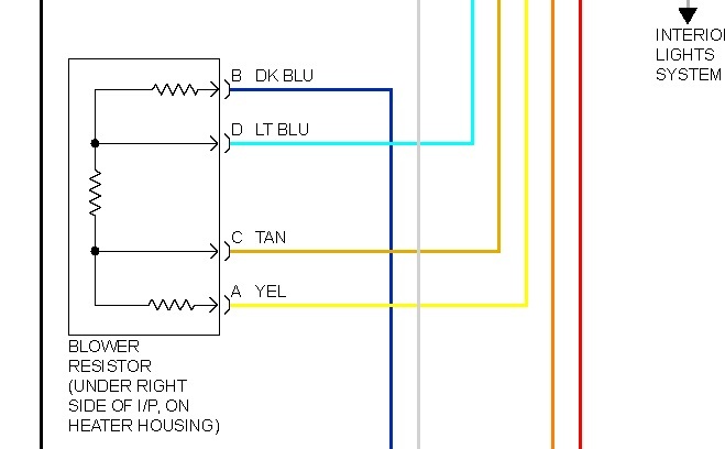

7.4
need locataion of heat&air blower motor resistor.it needs to be replaced. it has A/C
Sep 26, 2020 at 2:18 PM (Merged)
  • 75,992 POSTS
Blower Motor Resistor Wiring Diagram - Heater & A/C Underdash
https://images.2carpros.com/forum/automotive_pictures/12900_blowermotor_1.jpg
