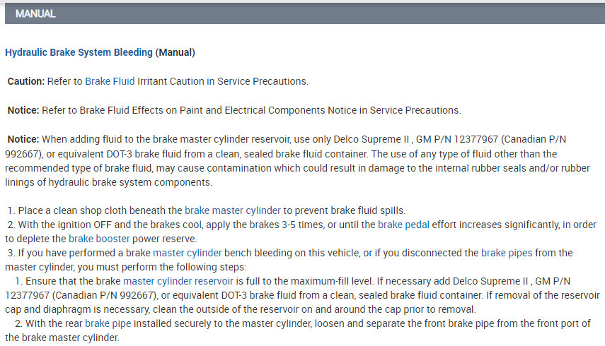

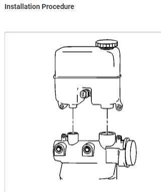

I need new brake master
2006 CHEVROLET TRUCK
52,000 MILES • V8 • 2WD • AUTOMATIC
MOTOXRACER801
the brakes are going to the floor they say I need new brake master. thanks

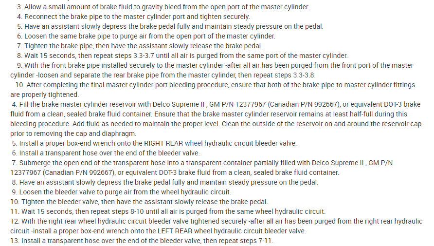

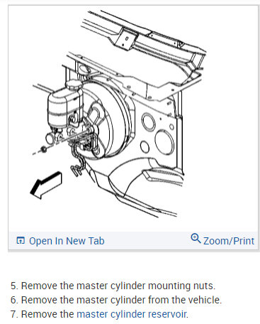

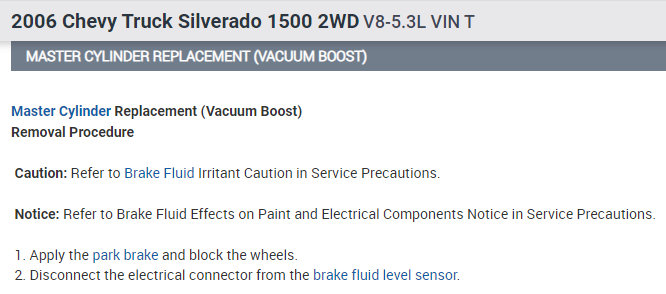

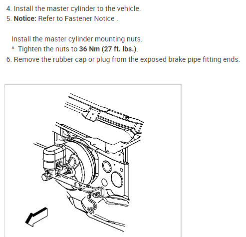

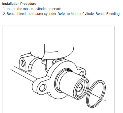

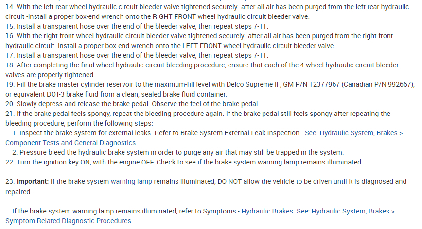

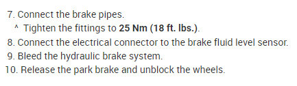

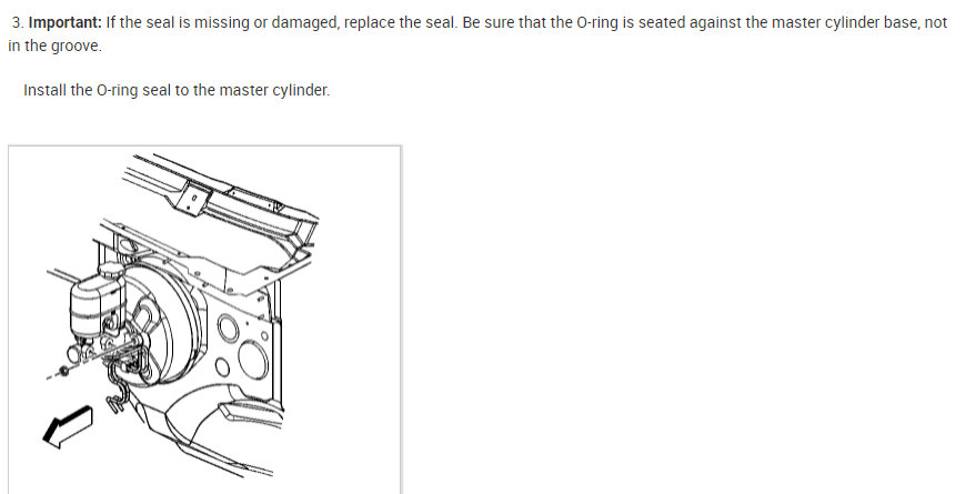

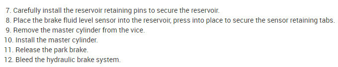

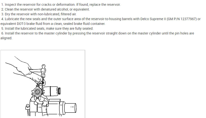

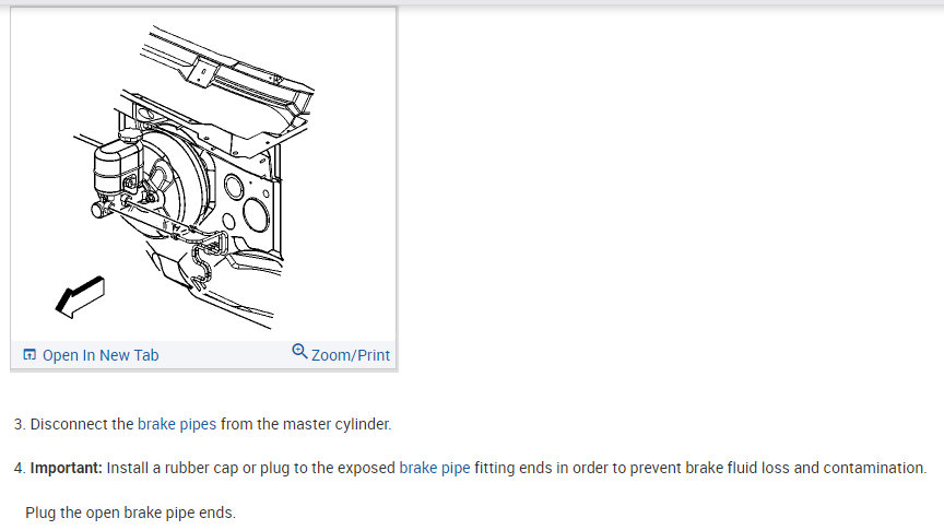

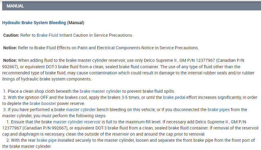

Here is the information you requested. Here are a few tutorials for you to view on how to replace a brake master cylinder and how to bleed the system after the repair has been made:
https://www.2carpros.com/articles/how-to-replace-a-brake-master-cylinder
https://www.2carpros.com/articles/how-to-bleed-or-flush-a-car-brake-system

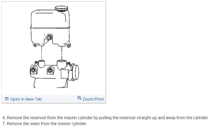

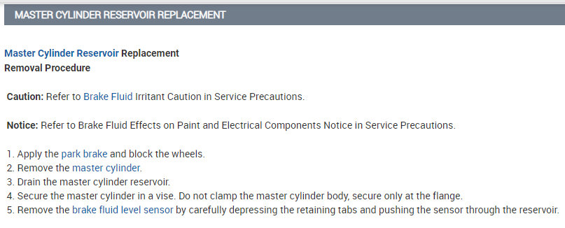

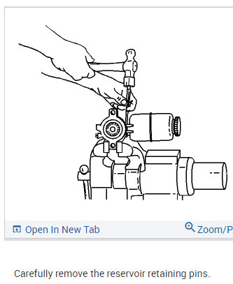

Since you are installing a new brake master cylinder it would be best to bench bleed the unit before installation to remove air from the new unit prior to installation on the vehicle. Here is a YouTube tutorial from our site showing how to do so.
https://youtu.be/WDxvEQrMkBg
I've attached picture steps below on how to replace the brake master cylinder and bleed the system on your truck. Hope this helps and thanks for using 2CarPros.
