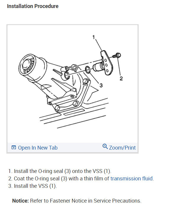

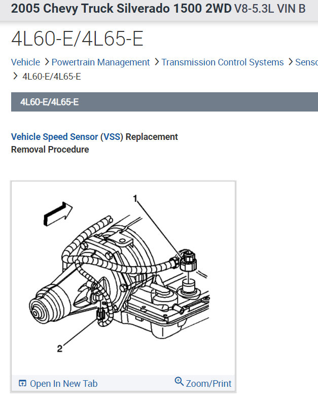

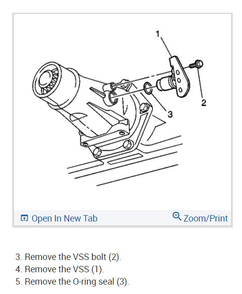

first of all, there is no speedometer cable on that truck, it is computer-controlled, called VSS vehicle speed sensor, it is located on the left side of the transmission check out the diagrams below to show you the location. Check out the diagrams (Below). Let us know what happens and please upload pictures or videos of the problem.
