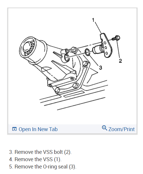

My speedometer suddenly JUMPED to 80mph, as I was only doing around 30mph. When I stopped and cut the engine, it dropped to 60mph and stayed. When I would start again it would start at 60 as if that was 0. I heard it could be as simple as a speedometer cable, but was also told it could severely affect my transmission.
Dec 13, 2009 at 7:32 AM
DR LOOT
  • CAR REPAIR CONTRIBUTOR
  • 2,311 POSTS

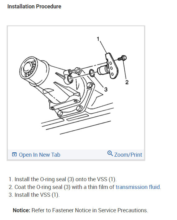

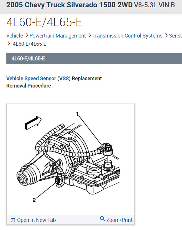

first of all, there is no speedometer cable on that truck, it is computer-controlled, called VSS vehicle speed sensor, it is located on the left side of the transmission check out the diagrams below to show you the location. Check out the diagrams (Below). Let us know what happens and please upload pictures or videos of the problem.
