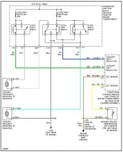

I am having trouble with my '01 Chevy Venture overheating. What we have boiled it down to is that the main and auxiliary fans do not seem to be kicking on. On top of that the compressor is not turning on. As this has all seemed to happen around the same time we are thinking they are related (duh, right.). We have checked our fuses and they seem to all be in working condition so I am now stumpted. Any ideas would be greatly appreciated. Picture attached for reference. [img:3486a6de5d]http://www.2carpros.com/forum/automotive_pictures/53445_IMG_2384A_1.jpg[/img:3486a6de5d]

Sorry, didn't re-read. It wouldn't have anything to do with it. Did you check the maxi fuses ( large fuse that looks like it is on steroids) in the underhood fuse box? Right front of the engine compartment? I know you said you checked the fuses, but want to re-affirm the right ones.
https://images.2carpros.com/forum/automotive_pictures/30961_coolfan_1.jpg
