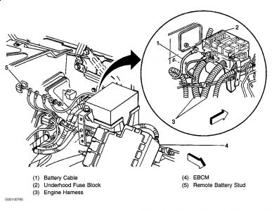

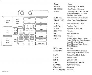

I have a 2000 silverado. The dash lights have quit working. It also affects the power mirror and the lights for the window controls on the driver's door. I have looked for blown fuses but haven't found any. What could be the cause?
Dec 2, 2009 at 2:20 AM
MIKE H R
  • 3,094 POSTS
check for any pinched wires, also here is the diagram of the fuse panel under the hood.
https://images.2carpros.com/forum/automotive_pictures/54223_silverado_fuses_1.jpg
https://images.2carpros.com/forum/automotive_pictures/54223_silverado_fuse_location_2_1.jpg
