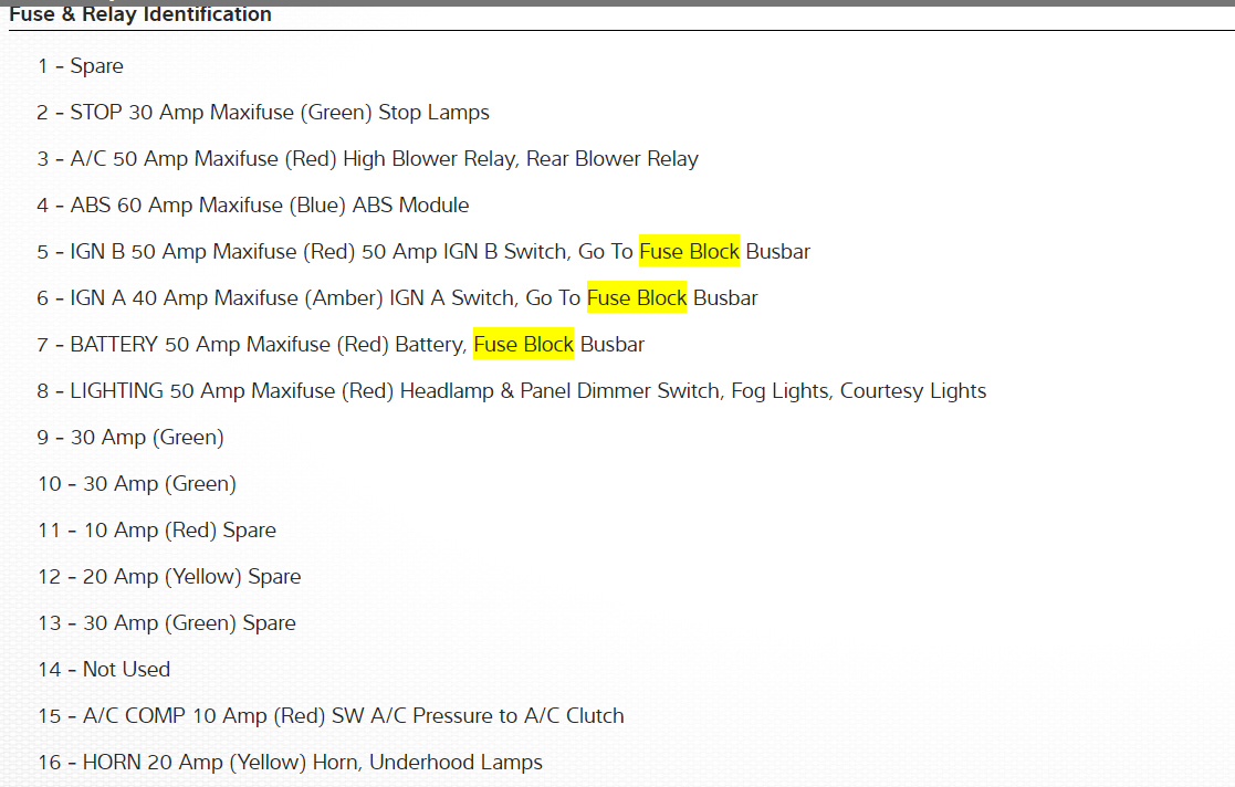

Our horn has stopped working. I can not find anything in the manuel about how to fix the horn. The diagram for the fuse box doesn't mention a fuse for the horn. How do I fix the horn?

We replaced the relay in my truck but it still will not work is there some fuses to change also the horn worked before can u help me

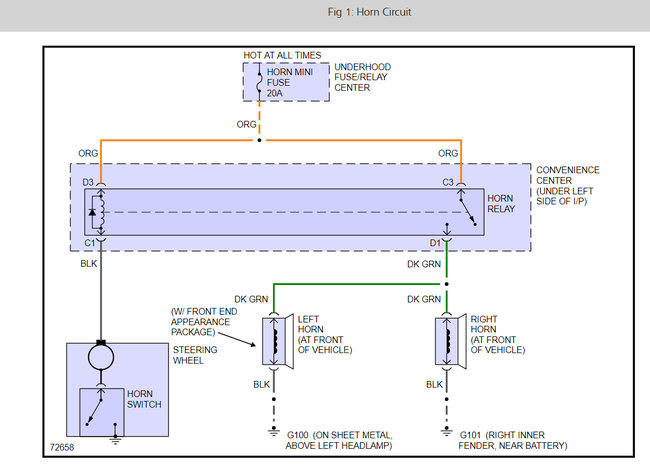

  • 75,992 POSTS

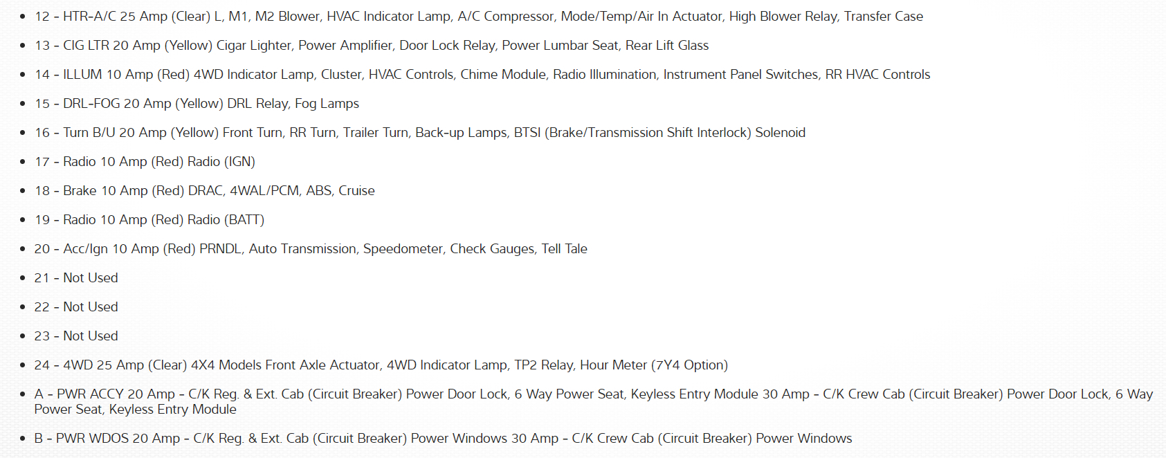

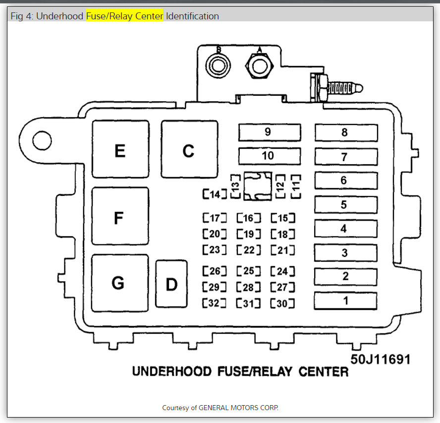

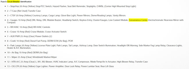

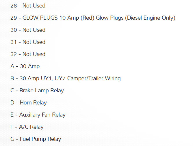

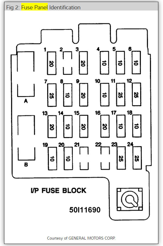

Here is a horn wiring diagrams along with the guide on how to check for power.
See if the relay is getting power.
Cheers

Check the ground for the taillight at back of frame driver side and check to see if horn has power might be the horn the horn and parking light fuse is behind kick panel lh side of dash and the relay is in the convience center left of steering column behind dash

I recently bought a 1988 chevy scottsdale (k1500) and it has an aftermarket air horn on it. That doesnt work, so I thought. I went out and bought a normal horn from o'reileys and put it on. But it also didnt work so I came to the conclusion that whoever put the air horn on messed up on the wiring somehow.
I am looking for a detailed wiring diagram or instructions on how to rewire the horn for this truck. I have a chilton's book but in this case it is not much help because the wiring diagram in it is for 88-96 chevy trucks in general
Wednesday, November 13th, 2019 AT 12:41 PM (Merged)
JDL
  • 16,098 POSTS
https://www.2carpros.com/forum/automotive_pictures/170934_88_chevy_horn_1.jpg
That was all I could find, probably the same as yours. You can check for voltage at the fuse. You can honk the horn from the relay, for testing. The black wire that goes into the steering column is just a ground for the relay, that is usually where the problem is located. If you find the wire before it goes into the column, splice in a redundant wire, for testing, the horn should honk, everytime you ground the circuit.
