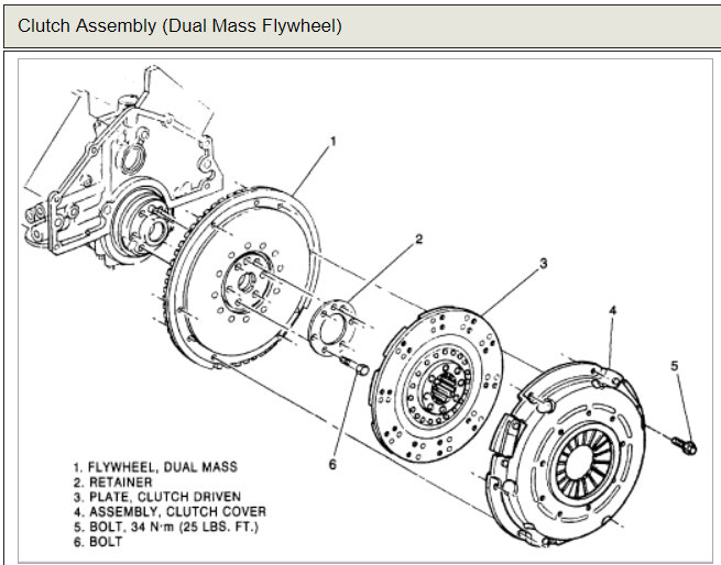

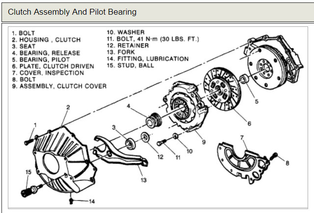

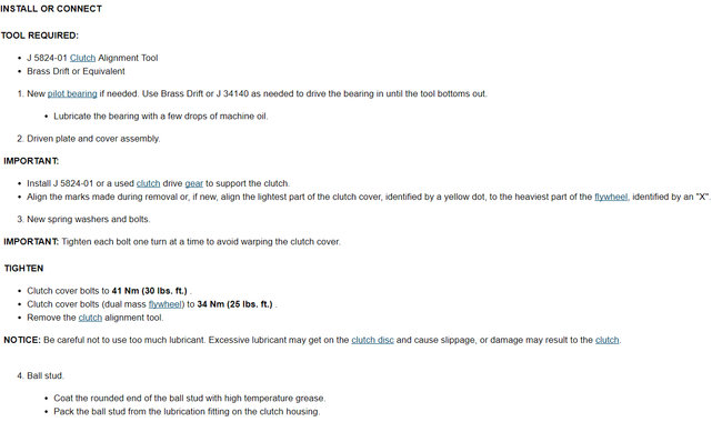

CARL PUSCHAK
How do you adjust the clutch on a 1995 chevy 4x4 pick up with a 5 speed transmission ?The clutch pedal has gotten soft and it's grabbing right off the floor.
Jun 20, 2020 at 6:16 AM (Merged)
  • 55,649 POSTS
The hydraulic clutch is not adjustable the mechanical clutch adjusters is on the slave cylinder but is sounds like the disc may have fallen apart causing the problem you are describing.
This may help
https://www.2carpros.com/articles/clutch-doesnt-work-sometimes-or-not-at-all
Here are guides that shows you what you are in for when doing the job.
https://www.2carpros.com/articles/transmission-replacement-removal-manual
and
https://www.2carpros.com/articles/how-to-replace-a-clutch
Check out the diagrams below. Let us know what happens and please upload pictures or videos of the problem.
