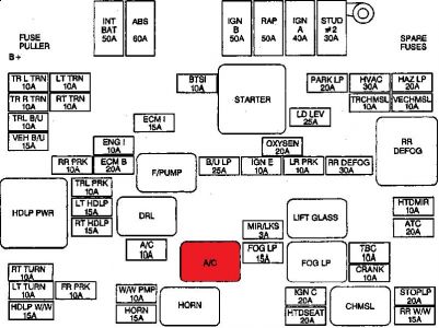

The air conditioner on my Chevy S-10 quit working. The problem seems to be that 12 volts is not being delivered to the solenoid clutch assembly on the compressor. The solenoid has continuity. I’m wondering if there might be an in-line fuse somewhere. Any help would be greatly appreciated.
Thanks.
Mar 15, 2009 at 10:59 AM
ZACKMAN
  • 4,202 POSTS

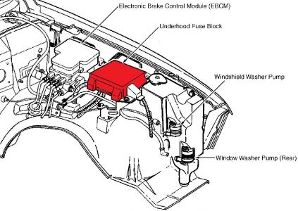

Power is supplied through an AC compressor relay inside the underhood fuse block.
