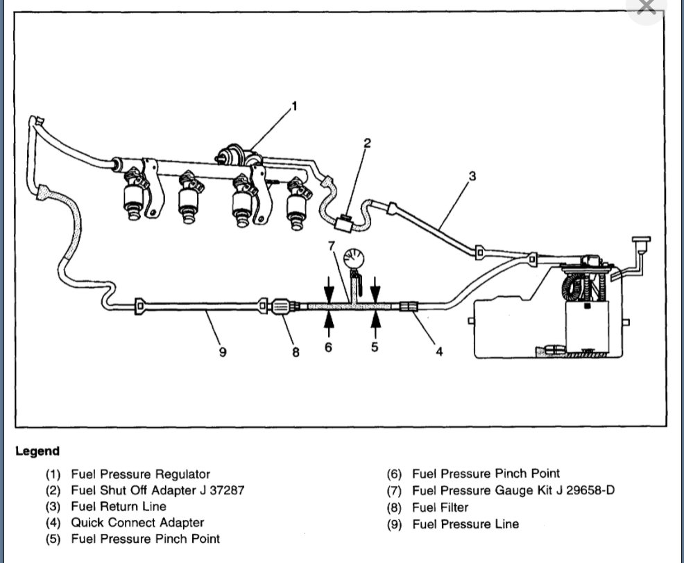

I removed my fuel lines to the fuel pump, I was unable to reach to the fuel pump to remove so I removed from the top at the fuel nozzle. My problem I didn't lable the hoses at the top so I don't know which hose goes to what line. There are 2 lines here with quick disconnects that run to the front of vehicle. Thanks

here is a diagram of the lines for a 4 cylinder S-10. They should be different sizes which means they will only go on one line.
However, take a look at this diagram and let us know if you have other questions.
Please see below for the diagram.
