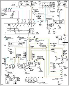

  • 54,854 POSTS
Hi, I checked it out, the power to the brake light switch comes directly from the fuse panel, so if the fuse is good and you are not getting power to the switch, a wire or connection has failed, you might have to rewire the circuit. I have in included the wiring diagram for the circuit.
https://images.2carpros.com/forum/automotive_pictures/10_wiring_1.jpg
you might need to blow up the pic to see it clearly.

PIKEJB
  • 6 POSTS
Ok, I fixed it. It was a fuse that I didn't know was there. I feel stupid b/c it took me a couple of days to find the fuse panel around the far left side of the dash hidden by a removable panel. I had checked the fuse panel under the hood and the one under the dash by the brake and gas pedals.
