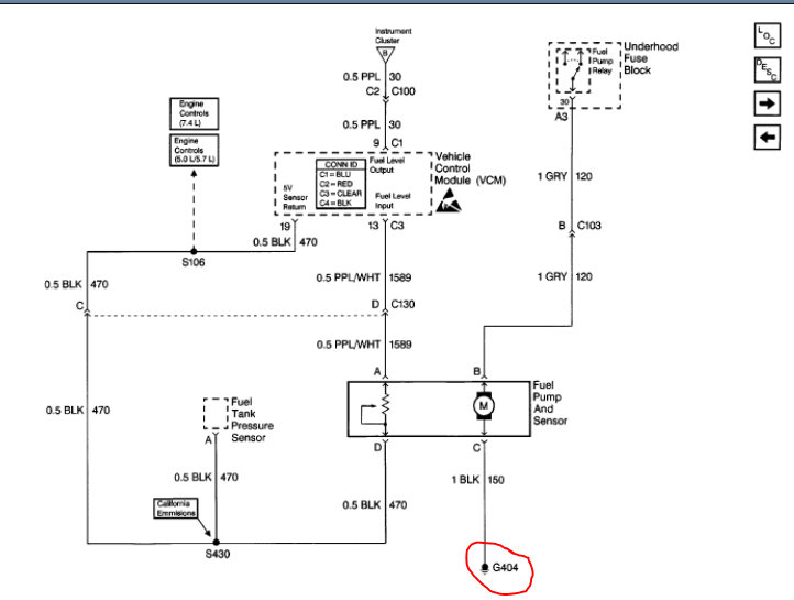

Hello! Recently, the fuel gage needle on the dash of our Suburban has started to shake wildly. I have not been able to easily find any information on the subject. Could this be a bad fuse? A short in the electrical system? Does anyone have any ideas on where we should begin to isolate the problem?

Just to add a little information to this post the 1988-1999 old body style truck has a fuel pump ground issue that will make the fuel gauge vibration issue you all have mentioned. Here is a tutorial showing how to test wiring:
I would suggest you inspect the fuel pump ground wire to check for damage, corrosion, or anything else to ensure a good ground connection. I've attached a wiring diagram below of the fuel pump circuit and circled the ground wire in red. Hope this helps and thanks for using 2CarPros.

Yes, it's unfortunately a common problem for this body style truck. I've owned two and it happened on my 1997 K1500. Let us know if you have any further questions on this issue or need any further instruction. Hope this helps and thanks again for using 2CarPros.
