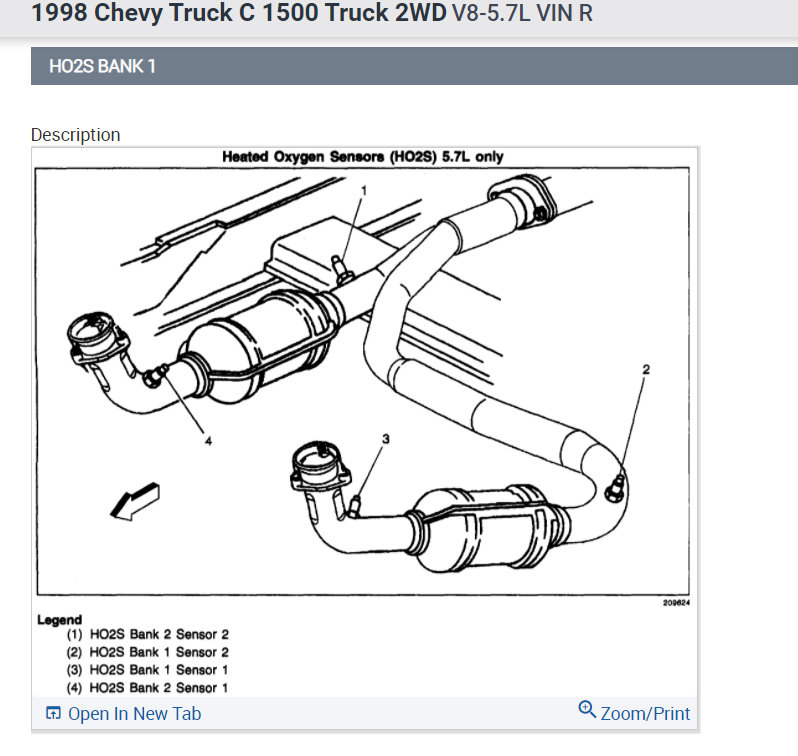

How many oxygen sensors are there on this truck and where are they at?
Jan 21, 2008 at 10:50 AM
BLACKOP555
  • 10,386 POSTS
the o2 sensors are located on the exhaust manifold before the catalytic convertor(s) you may also have some located after the catalytic converter for catalyst efficiency. Here is a guide to help you step by step with instructions in the diagrams below to show you how on your car.
