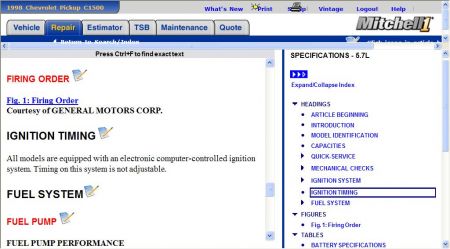

Confirm if its getting fuel and spark before we go into ignition timing or do below
Get a carb cleaner and spray into the carb or the throttle body on an EFI. Did it start and die? If not disconnect a sparkplug wire or 2 and ground it to the engine -have helper crank engine over-do you have a snapping blue spark? If so-you have a fuel problem, check the fuel pressure to rule out the fuel pump/pressure regulator and listen to the injector/s are they pulsing or hook up a noid light.
Fuel pump and Injector/s checks out-start checking the ignition system-power to coil, coil/s itself,distributor pick-up,control module, Cam and Crankshaft sensors.
If both fuel and spark is present-check the valve and ignition timing, this will lead you to problems with compression and valves opening and closing at the wrong time

https://images.2carpros.com/forum/automotive_pictures/12900_timing_9.jpg
